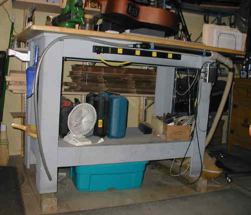

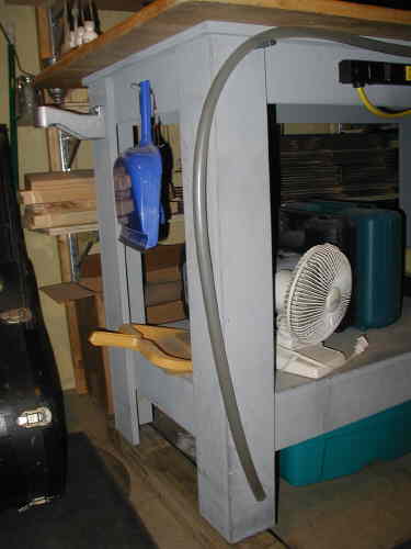

Here are a couple of photos of the workbench that I inherited when MARS went out of business here in Cincinnati. I believe these workbenches were built for all the MARS stores. I had three of these benches in my shop at MARS. We always liked the simple design. It is very sturdy and I believe it can be built out of one 4x8 sheet of 3/4" plywood. It is just glued and screwed. I've raised my bench with two 4x4's to make it easier on my back. I've also added a hardwood table top (rubber wood I believe) that I was given by a foreman at the furniture distributor I worked for years ago. I like the hardwood better than working on the ply top. I holds up to abuse better. I can measure and provide a cut list if you are interested.2005-04-16_003539_Workbench.JPG2005-04-16_003604_Workbench2.JPGNeil38458.0292939815

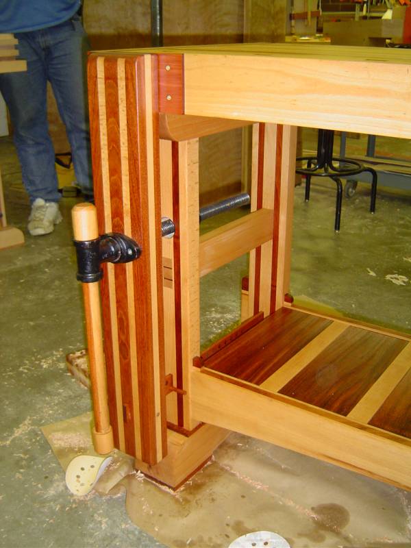

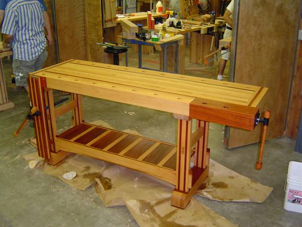

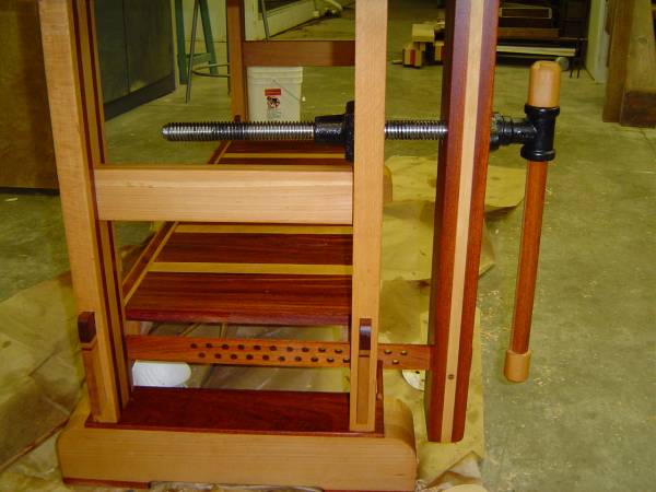

Here a some shots of my bench I built last year. I specifically wanted a clamp I could use for holding the guitar neck while carving it. This is what I came up with and it works like a dream.

Robbie, now that is a workbench. Nice work! Do you worry about scratching it? It is almost too beautiful to use as a workbench.
PostPosted: Mon Apr 18, 2005 5:43 am
Posts: 2356
[QUOTE=Neil] Robbie, now that is a workbench. Nice work! Do you worry about scratching it? It is almost too beautiful to use as a workbench.[/QUOTE]
I did want to use it for my kitchen table but the wife wouldn't have it!
I worried about scratching it and getting it dirty for a couple of weeks but then I started using it and didn't worry much about it. The finish is linseed oil and wax so it cleans up pretty easily.

Robbie - what is the total cost and time you have into that bench?

Robbiue, That is a beautiful bench. I too went for a Swedish design when I built mine a couple of years ago. Mine is decidedly more utilitarian but is made of all hard maple and is moveable (casters) beacuase my shop is long but extremely narrow. This style of bench lends itself very well to carving and the use of hand tools. Even with the casters, it is extremely stable.

[QUOTE=jfrench] Robbie - what is the total cost and time you have into that bench?[/QUOTE]
I have about $450 in material - two vises, european beech and jatoba.
I have about a month of work putting in about 4 hours a day.

Very Nice work. I like the bench dog holes in the top.
When I built my bench I made sure it had them.

Thanks for the compliments. My bench has done everything I designed it to do and more. The bench dogs are a nice feature.
